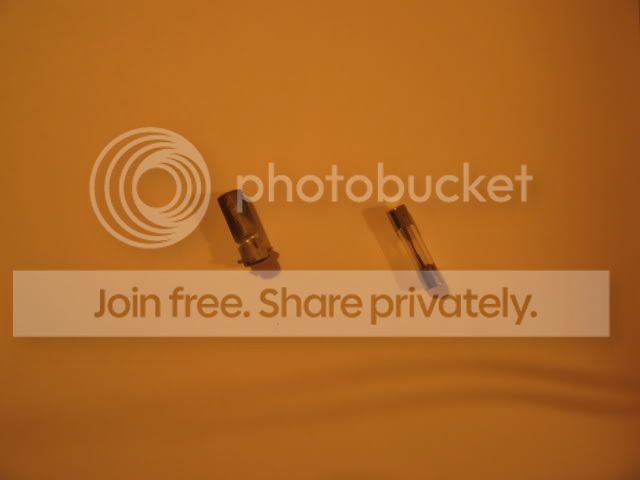

Your two photos are basically what I have on the back of my '36 ammeter.
What I don't see in the pictures is the piece which you push down on and rotate to lock in the glass fuse. When I put an inch and a quarter 20 amp glass fuse in my holder the end piece locks it tightly in place.

Here is a pic. Hope it comes out.

The fuse doesnt look like the same as a regular car Buss fuse. The braket has a push and twist type holder. A glass type would just fall out. The size of the holding bracket is about twice the circumference and has the notches. If i could send a picture to someone via email, they would be able to see what I was talking about. I didnt have the holding bracket on my original guage so I took that off of another to make the one. The wiring diagram called for one so I assumed it neede it. Thanks

I measured the 20 amp fuse that is on the back of the ammeter of my '36. It is an inch and one quarter long.
Etched in the metal cap on one end is: SFE 20  BUSS     Buss is the name of the manufacturer. I would imagine any auto parts store would have them, or could order some for you. They usually come in a tin of 5 fuses.

there were two different length  glass tube fuses a short and long i dont know the length of the short but your car takes the longer one which is 1 1/4", and yes it does push in and twist to hold it .
