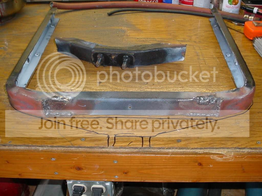

Don Coatney
#7
I have installed a Desoto long block flathead 6 engine into my 1948 P-15. Of interest if your engine has a "Spitfire"
head it is either a Crashler engine or someone has installed a Crashler head on it. Spitfire heads were only used on
Crashlers. The engine serial number should tell you what it is.
Here are a few of the "shade tree" things I did to make this engine fit.
I had to modify my front cross member to make the harmonic damper fit.
I also had to not only reverse the radiator bracket but also modify the radiator bracket lower mount.
Even with the modified bracket the radiator still sits too close to the waterpump to use a belt driven fan.
I had to go with an electric pusher fan and also notch the fenders out so I could install the radiator.
There are several other minor things required. It was a tight fit to get this engine in there but well worth it in my book.
I have driven this combination about 15,000 miles with no problems. I live near Nashville, Tennessee. I have driven my
car to Northern Ohio, Northern Indiana, Tulsa, Oklahoma, Concord, North Carolina, Arlington, Virginia, and I have plans on
driving to Detroit, Michigan later this month. In addition to this long block Desoto engine I have installed a 5 speed
overdrive transmission and a 3.55/1 differential. I can run 70 MPH and the engine is only turning 2200 RPM's. With this
combination I can pull all but the steepest of hills without down shifting. If I can be of additional assistance let me know.
Don Coatney
