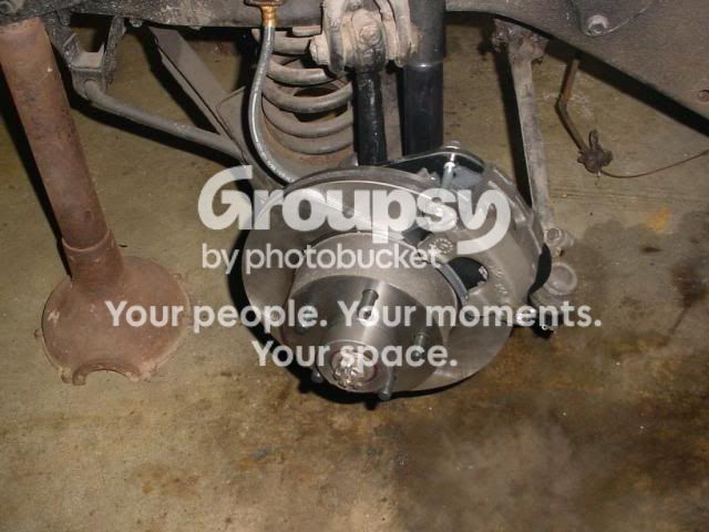

I did not see any pictures supplied with the original question. The only pictures I see are the ones I posted in response to the original question. I guess I must be the fellow using the stock type original single chambered master cylinder installed with what looks like shade tree enginnering. However I must state that my disc brakes work well (much better than the originals in my opinion) and have worked well sense the day I installed them over two years ago. First thing I did once the disc conversion was completed was a front end alignment and everything alignment wise is well within spec. Aside from the safety improvements this upgrade acomplished I can now go into any bubble pack auto parts store and purchase any components required to make repairs on the road. I am currently working about 250 miles from home on a two week temporary assignment in Atlanta, Georgia. I drove my Plymouth and feel comfortable driving in the Atlanta traffic. I know, understand, and respect that this POC forum is dedicated to the original preservation of the Plymouth automobile. But I feel that any safety upgrades to make these cars more drivable as daily transportation (as they were originally designed) should be a fair topic of discussion on this forum.

I have front disc brakes with the original master cylinder also.  They work great.  The brakes improve the drivability of my car at least.

Quote from: 52plym on September 23, 2006, 12:16:14 PM
I recently installed disk brakes on the front of my '52 Belv.? After careful bleeding, adjusting, etc., my pedal travels to within an inch of the floor before the brakes are applied.? According to info from others, the problem is that the "juice" is not being applied correctly with the disks in front and the drums in rear.? I do not want to redo the braking system ie. master cylinder etc.
Apparently, I need a proportioning valve, but I can't find one to fit the old master cylinder system.? Does anyone have any suggestions ?

First fill out a profile on that forum so everyone knows a bit about you and your car. Several folks that frequent that forum have done the conversion. You need to install residual valves in your brake lines as has been mentioned. The original master cylinder will work well once you do this. I have installed disc brakes on my P-15 and I recommend this up-grade. This up-grade can be completed for less money than the eBay cost of the Ammco brake adjusting tool that is required to correctly adjust the factory brakes.

In my experience,  a proportioning valve does not affect pedal travel. It affects the front to rear brake bias.
I do not know if you swapped master cylinders or not, but when swapping from drums to discs you normally use a MC with a larger bore.

I have front discs also.  I have the red, and blue valves, but to be honest, I am not sure which goes where.  I can take a pic later and post it, but you should be able to google it.  Mine were from Plydo.  And you should be able to cut into the lines no problem.
