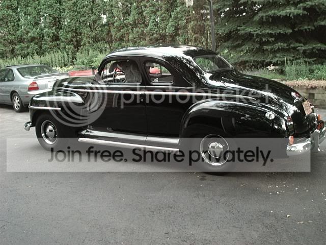

hotrodguy34
nice car,
no, i know the bumbers aren't right. i don't want to piss any resroters off, but i AM a street rodder. i've had this car for about 3 years. the bumbers were real bad when i got it, so i bought some "briz" bumbers, they are repro's of the later desoto bumpers' and the brackets have been shoutened about 2".
i'm in wisconsin,  i just finished painting the car yesterdat, these atr older puics. it's now " hotrod black", thats basecoat clearcoat with a deadened clear coat for a matte finish. i've already installed a 68 8 3/4 posi rearend, and haven't gotten around to the engine and trans yet. as i'm getting a little older now, i'm not so concerned with thne big burnouts, so i'm thinking about a slant six. if i want speed, i have a steel 34 ford with 500 h.p. in it to handle that job. i have three of them here, and a a 833 overdrive trans. it still may get a hemi though. the running  boards have been filled and smoothed, and done in truck bed liner.
  as i was suspecting, the dash may have been retrofitted. it lookss real good in there though.
thanks for the reply.

The dash looks to be a p15 (46- early 49 P15) the bumpers are also not 41.  the wheels look like the Wheelvitique smoothies I have on my P15.  What is the engine number?  It on the block just above the generator. The cowl shape on the cars stayed relativly constant from 40 to 48, so the dash board swap was a pretty easy swap.

hi,
i'm new to this forum, but thought it would be a good place to get information on a few things that have been bugging me about my 40-41 plymouth.
this car spent it's whole life in california, except a few years in arizona where is where i got it from. now currently in wisconsin.
it is titled as a 1940 (oct of 1940), but there is no doubt that it is a 1941 the body number matches the title. i know that they use to start building the new models a few months early, so that isn't the issue. i am just wondering why it is titled as 1940 instead of 1941?? possibly thats the way they did it in california, by registration date, not model year.
NOW THE REAL CONFUSING ONE IT HAS A LATER MODEL DASH IN IT (46-48)??  the only thing i can think of is a custom install, but it looks like it grew there. nothing cobbled,allbrackets seem correct cowl vent linkage etc
now my next one ::::  it is a buisness coupe, but i am confused on the model   p10-p11-p12 i don't really know where this one falls. i know it's not the original engine though.
i would appreciate any input from anyone that knows a little more about the plymouth history
thanks in advance
